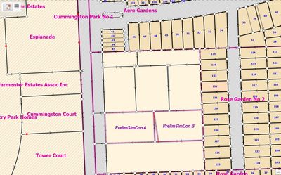

  1. We agree that if you are showing the gaps and overlaps on multiple layers at once, it could be challenging to know which layer it is in. We would suggest having a way to navigate the errors (like how the Error Inspector allows the ability to zoom, flash, etc.). This would solve the initial problem of not knowing which layer the problem is in, and it would also make it easier to find the errors when validating a larger area. Consider the scenario of showing Highlights on a new subdivision. The Highlight tool currently doesn’t indicate how many errors exist in the area being validated, and the area is large enough that small, highlighted areas could be easily overlooked. I'm attached 2 pics that hopefully illustrate that.

common extent we would validatecommon extent we would validatevery easy to miss the error on the east sidevery easy to miss the error on the east side
