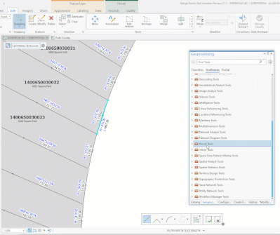

In ArcGIS Pro you can run a geoprocessing tool to validate (check) your parcel fabric.
Beyond the rules you can configure to meet your business needs the result are error features that can be inspected visually on the map as well as in the Error Inspector:
