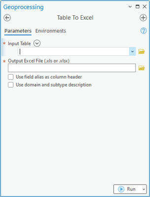

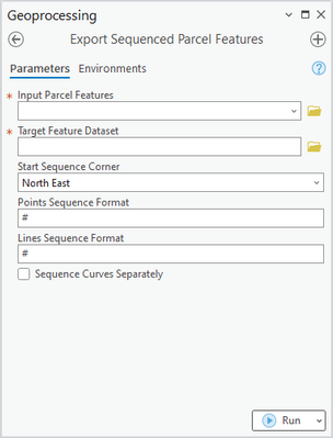

I ask because ArcGIS Pro 3.1 will has a new geoprocessing tool called 'Export Parcel Sequenced Features'. It  exports the parcel lines in sequence, which you can then export to a CSV  or even an excel spreadsheet using the 'Table to Excel' tool.

Unfortunately we are not yet using the Parcel Fabric, although we do plan to implement that in the future. I will look into that tool, as it sounds like just what I'm looking for.
AmirBar-Maor
Once ArcGIS Pro 3.1 is released you will be able to learn more bout the tool in the help doc: https://pro.arcgis.com/en/pro-app/3.1/tool-reference/parcel/export-sequenced-parcel-features.htm
https://pro.arcgis.com/en/pro-app/latest/tool-reference/conversion/table-to-excel.htm

You can always create a geoprocessing model with the 2 tools to export the lines in a single step.
