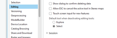

Just to let everyone know, at 3.1 there will be an option in the back stage (Editing section) that will allow you to set the default tool when deactivating editing tools.  You can now always revert back to the last used Select Tool when exiting Edit Vertices for example.

Status changed to: Implemented
This Idea has been implemented in ArcGIS Pro 3.1 as an option in the backstage. You can change the default tool for editing all features to be either Explore or Select. This can be changed by going to the 'Options'>'Editing'>'General'>'Productivity' section.
