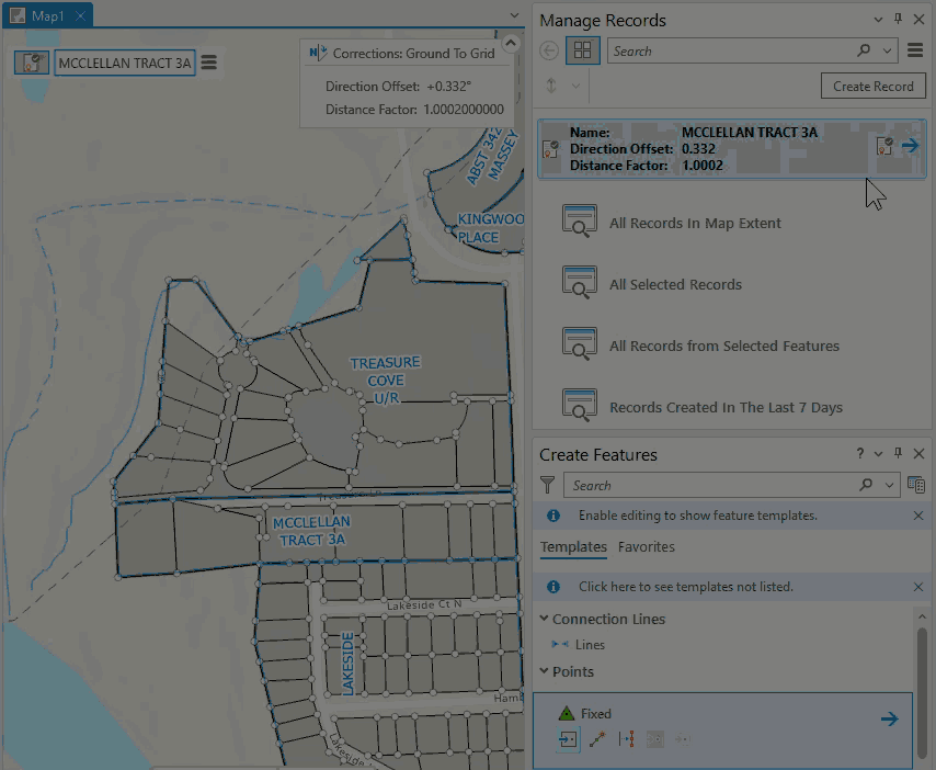

TimHodson
Hello @TomNeer and @DennisTebo
There is an add-in available that will set the ground to grid values whenever changing the active record. It leverages enhancements made to the Parcel Fabric API with 3.2. If you have 3.2 or higher, you can install the add-in from here.
There are some schema changes required.
To use the add-in: after installing it you opt-in to the functionality by creating two [double] fields on the Records feature class called 'DistanceFactor' and 'DirectionOffset'. Type in, or calculate the appropriate direction offset and combined scale factor values into these fields for the records in the records feature class.
The map's ground to grid correction will change to the (non-null) values found in these fields whenever a record is activated. If the value in the activated record is null, then it will not change the currently set ground to grid value.
Set Ground To Grid From Active RecordSet Ground To Grid From Active Record
You can also use the add-in button called 'Save Ground To Grid To Record' on the active record's heads up display menu to save the map's ground to grid correction values to these fields. Existing values will be overwritten.
For all who use this add-in please provide feedback on its functionality; this will influence our implementation of the functionality in the core product in a future release.
