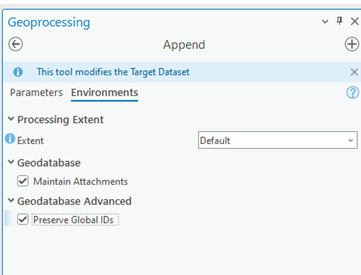

Preserving GlobalID values seems to be a topic that has been discussed at length, and while we are able to preserve GlobalIDs with the Append tool (providing we are appending into a Mobile Geodatabase), the Upgrade ArcMap Parcel Fabric tool does not appear to honour the ‘Preserve GlobalIDs’ environment setting, either in Mobile Geodatabase or File Geodatabase. Here is a screenshot of how we ensure the Append tool honours the Preserve GlobalID setting:

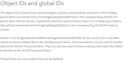

Implemented with ArcGIS Pro 3.1.
See help documentation
