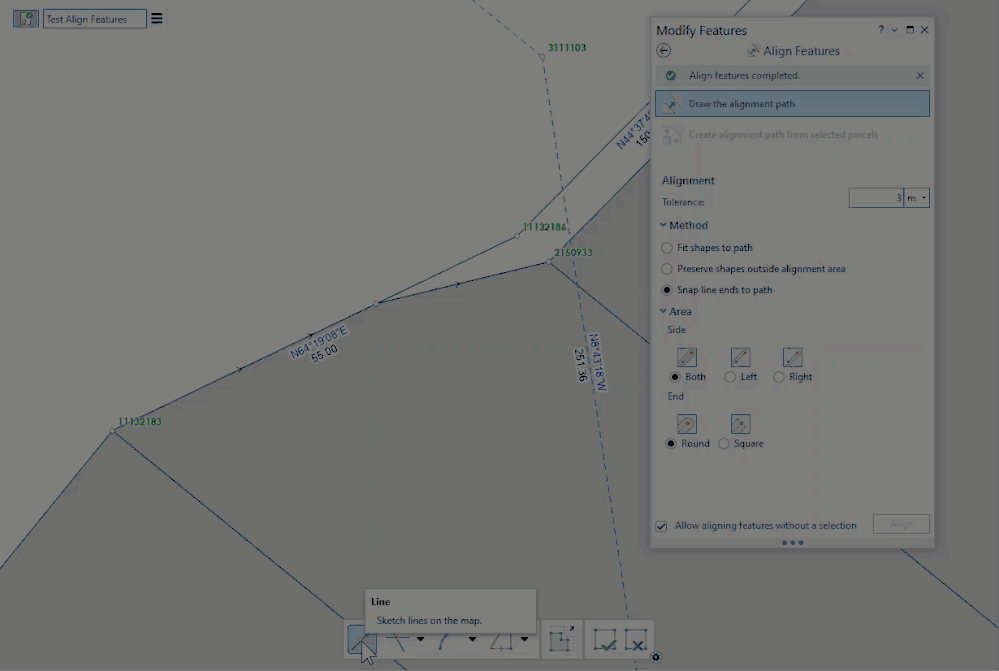

We are using an ArcGIS Pro parcel fabric and often rely on the Align Features tool to fix up certain gaps/overlaps/old join mistakes in the data. While this typically works ok, the Align Features tool seems to only honour the GDB topology, even if I have Map Topology specified in the Edit ribbon. With how our connection lines intersect our parcel lot lines, this means the Align Features tool will crack the data at these intersections. The video below demonstrates the behaviour I am describing:

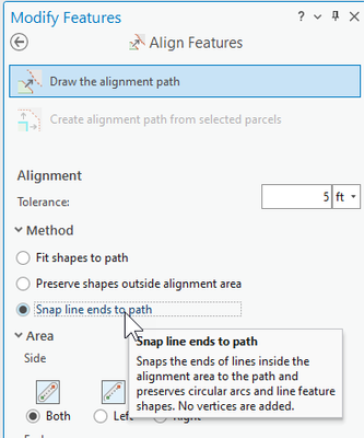

Hi @MizukiKayano2 and @CathyAppleton Please try the option to "Snap line ends to path"and let us know if it solves the problem.  This option is the most conservative in terms of introducing new vertices and is much better at preventing the creation of bends in the lines.

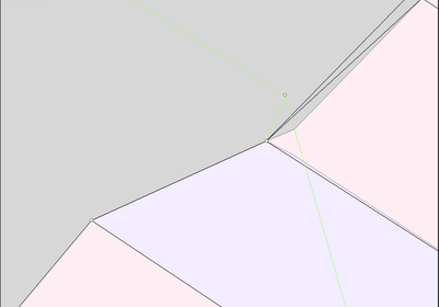

We then set our dataframe to BC Albers so we would not be projecting on the fly and we are not getting the same results as you. The tool completes, but the topology is broken and the data looks bad:

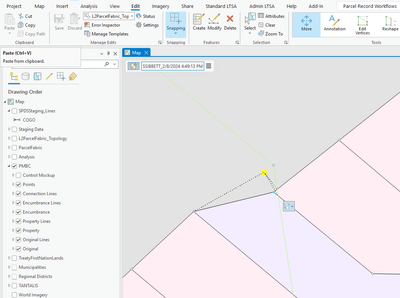

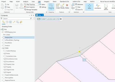

The steps you've outlined will work, but something to consider is that other tools (Move tool, Edit Vertices tool) do not require these steps, so long as you have the topology set to Map topology and you have your connection lines not visible. This seems easier to me than shrinking to seed or running SLACA.
Here is the Move tool with GDB topology (the rubber banding is split at the connection line):
Here is the Move tool with Map topology (the rubber banding continues the full length of the parcel):
The Edit tool functions the same way as the Move tool. It's just the Align Features tool that doesn't seem to honour the Map Topology setting. If it did, we could avoid running extra tools (like shrink to seed or SLACA). For now, I think we would probably use the Move or Edit Vertices, but it is good to have a workflow for the Align Features, so thank you for sharing that.
