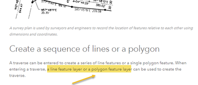

If you are not interested in saving the COGO measurement you type, and if you think you will never modify your entered traverse, than you can also use:
1. A non COGO enabled line feature class
2. A polygon feature class
This is documented under the Create A Traverse help topic which I find by doing a quick web search:
I would recommend using a COGO enabled line feature class to enjoy the symbology and labeling that comes with it which makes it easier to verify that you enter the correct dimensions as you see them appear on the map and then use the editing tool Construct Polygons.
