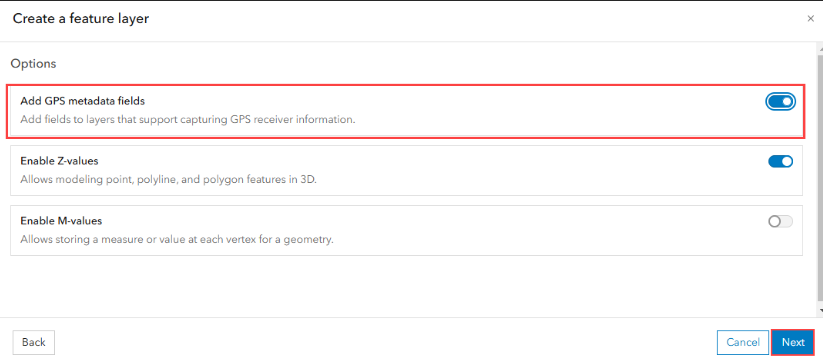

When you create a new hosted feature class in AGOL you will see this option:
If you don't have to record all the GNSS metadata, try to create your layers without the setting turned on.
