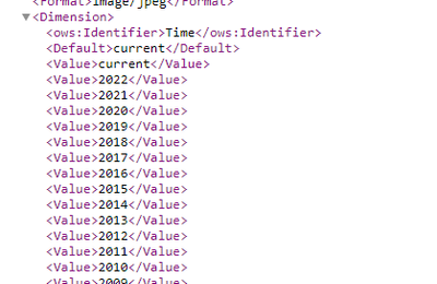

1.specify the desired time parameter in the url with the value you want. Replace {Time} with any of the values from the time value list for that layer in the capabilities xml. Here is an example snippet from the xml for the SWISSIMAGE Zeitreise layer:
2. Adjust the XYZ parameters, replacing {TileMatrix}/{TileCol}/TileRow} with {level}/{col}/{row}.
That should give you a url that looks something like this (with 1956 being used as the time dimension).

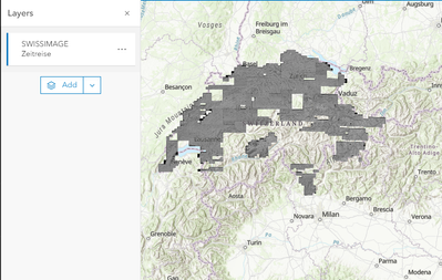

https://wmts.geo.admin.ch/1.0.0/ch.swisstopo.swissimage-product/default/1956/3857/{level}/{col}/{row...
Those changes appear to help add the layer successfully for me when I tried (I also applied the Darken blend mode so the basemap shows through for reference):

Hi Chris,
Thanks a lot for your help, it works for me now.
Replacing "{TileMatrix}/{TileCol}/{TileRow}" with "{level}/{col}/{row}" was the point I had missed.
