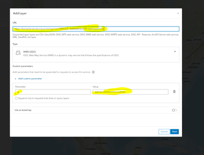

The OGC WMS below will open and display in AGOL WebMap Classic. However the same WMS appears to load but will not display in the current AGOL WebMap. Have tried a couple of display parameters to no avail. Any thoughts on how to get the layer to display greatly appreciated.
https://biocache-ws.ala.org.au/ws/ogc/ows?q=species:Austronomus+australis&SERVICE=WMS&REQUEST=GetCap...
Regards, Damian
Tags (1)
2 Solutions
ZaraMatheson
Hi Damian, Thanks for reporting this. We are investigating the issue. In the mean time you can try adding the url with a custom paramater that replaces the + with a space and it should at least initially render in MV.  See below:
ZaraMatheson
