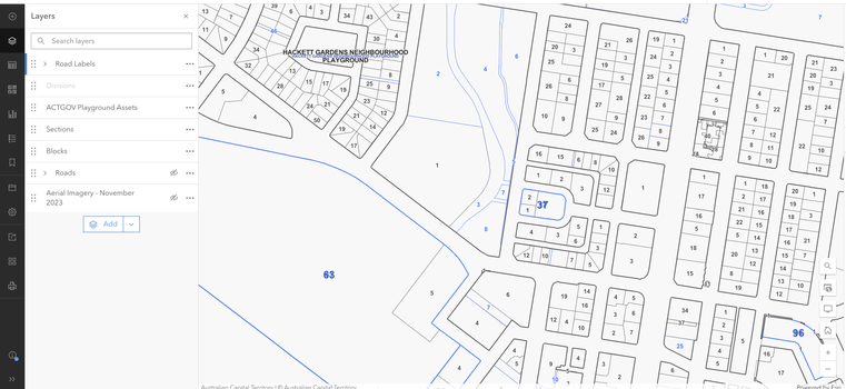

I have been having duplicate label issue when using scale-based sizing for label in ArcGIS Online (I found no issue when viewing the web map in ArcGIS Pro).

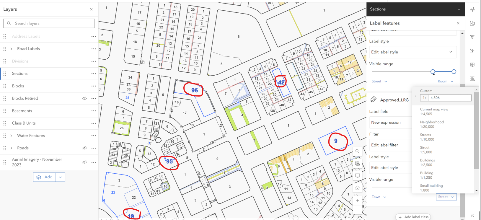

I have a feature service, called Sections in the web map, which is basically displaying a boundary of land parcels group. I created two label classes to display the section numbers at a different zoom levels, as below:
  • 1st label class (APPROVED) is set to display the labels with the scale range of 0-4505.
  • 2nd label class (APPROVED_LRG) is set to display the labels with the scale range of 4506-36111

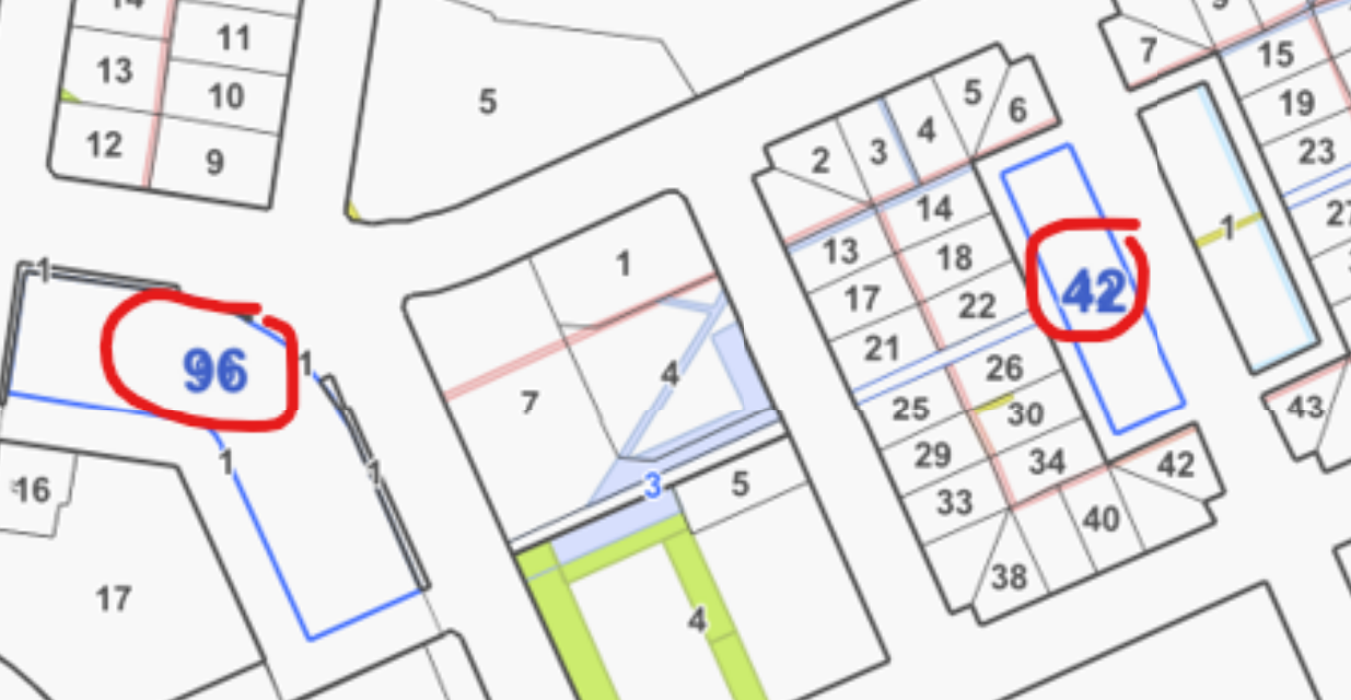

However, the labels from both classes appear when I zoom in to the 4505 scale, result in duplicates. As can be seen from the screen shots:
Has anyone encountered similar issue or found any workaround to deal with such issue?

Thanks, I can see the issue and looking into it. As a work around I bumped the max scale for the SML class to 4700 and that removed the issue and I couldnt spot a drop in labeling when viewing it through a web app and changing scale.
