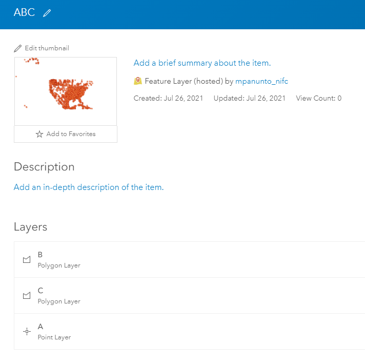

When publishing a service via GDB upload, I assumed feature layer order was determined by the alphanumeric sorting of GDB feature class names, but this does not seem to be the case. My GDB has 3 feature classes, a Point, and two Polygon feature classes. They are named:
"A" (Point)
"B" (Polygon)
"C" (Polygon)
When I upload the GDB to publish the service, the resulting layers are in  B-C-A order. I want them to be in A-B-C order. How do I do that?

GB_MattPanunto_GISS
Here you go. The first image shows the GDB from within the Catalog Pane. While the second image shows the resulting service that is published by uploading this GDB to ArcGIS Online. There are no unexpected characters in the names of the GDB, or the feature classes.

MatthewBrown8
Thanks for providing further detail GB_MattPanunto_GISS.
I performed a number of tests and was able to reproduce the described behavior. The results suggest that while feature layers stored within a file geodatabase adhere to alphanumeric ordering, when published to ArcGIS Online as a hosted feature layer, the layers are listed according to the order they were created in. This is further highlighted in the attached images, where layer 'F' was created before layer 'E'.

GB_MattPanunto_GISS
Ahhh good sleuthing! Glad there is a way to resolve this issue. Can't help but wonder, is this working as intended?
