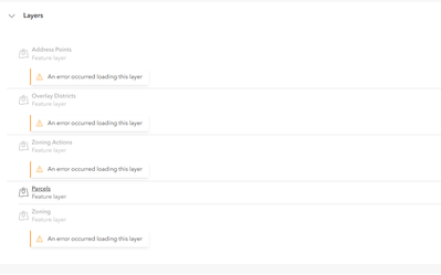

Even upon opening the map, the layer loads perfectly. I can see updates instantly in AGOL, and I can search the layer. It is great. The weird issue I am having is actually on the item details page of the web map where the layers were replaced. All of the layers that I have migrated into this web map from the portal by replacing the URL show the following error:
Parcels is the only layer that is still pointing towards its AGOL version, rather than the portal. I would really like to figure out why this workflow has broken the item details page, if possible.

@MDB_GIS  - I tried this using AGO Assistant.
I replaced the URL and itemID and I do not see the same issue.
The only way I have been able to recreate the issue is by entering the wrong itemID.
That being said, in these situations I use the ArcGIS Pro approach.
Open the map in  ArcGIS Pro -> Update layer sources -> Save webmap.
This does not change the URL of the map so no need to update any other apps that use this map.
I try to avoid using AGOAssistant to make changes in webmaps until I absolutely have to.

MDB_GIS
I can't believe that I didn't think to try that. Updating the source that way repaired the issue! What's odd is that I definitely had the itemID correct, because it is the same now as it was before. Must have just been a weird bug. Either way, I will definitely use this method from now on. Thank you for your help!
