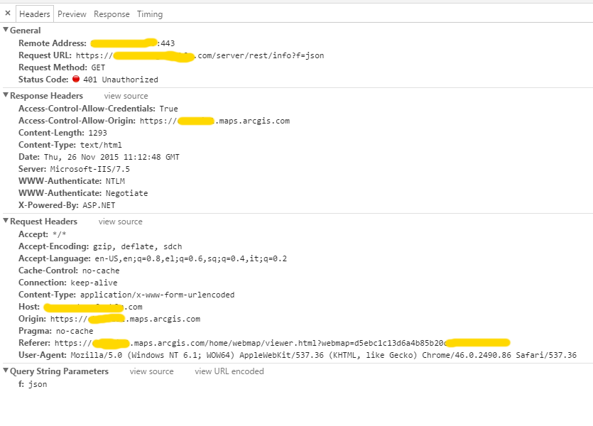

3-) When that mapservice is added to that map the requested url fails with error "401 Unauthorized"
https://servername.com/arcgis/rest/info?f=json
As you can see from the image we have configured the web.config of the IIS where the webadaptor is running to use CORS. The origin sent by the browser matches the origin declared on the server.

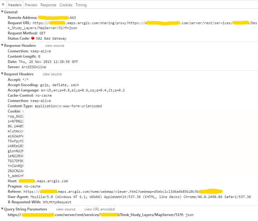

5-) The other error raises when the select to configure the Popup for the Related Table.  Here we get the error "502 Bad Gateway"
After the 502 error the user can't change the popup configuration and that is a problem.
Please note that on the second request AGOL uses a proxy.
