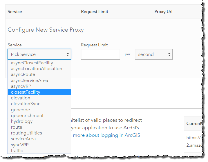

I was hoping I could use the ArcGIS Online hosted proxy, but this appears to only allow you to configure proxies for the esri credit consuming services.  Was hoping their would be a proxy to allow just access to the content that is also owned by the same user that registered the app.
