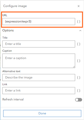

@ZorbaConlen, I think you can actually use Arcade here!

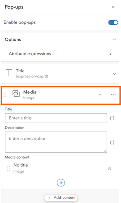

I'm assuming this is how you're getting the image into the pop-up:
If so, click on "Attribute expressions" and create an expression something like this:
// The first parameter is your constructed image URL
// The second parameter is your backup/no-image image URL (I grabbed a random image from the ArcGIS blog)
return DefaultValue("https://<domain>/Images/SurveyReports/" + Text($feature.CONTROLID) + ".gif", "https://www.esri.com/arcgis-blog/wp-content/uploads/2025/11/CapBld_WIDE.png")
Once you have that expression created, you should be able to choose it as a "field" (click on the curly brackets):
