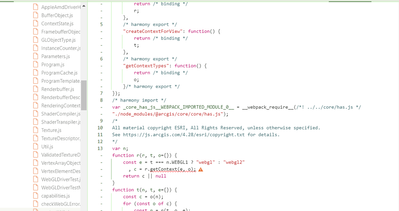

In Custom React app on JS 4.29, we are utilizing multimap view and each map view approximately 8 feature layers through FeatureLayer.
In one screen 2 map views, and loading layers dynamically on these map views, to reduce webGL contexts intializing map, and view every time before loading the layers.
I tried map.destroy(), view.destroy() and also applied tryFatalErrorRecovery but still some times map went blank means nothing is displaying on map.
As a result of this error, the map displays as blank, and all added layers are removed. It's worth noting that in the blank map, the search and zoom in/out controls are still visible, but the layers are not showing.
We would greatly appreciate any suggestions or guidance on how to resolve this issue.
