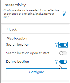

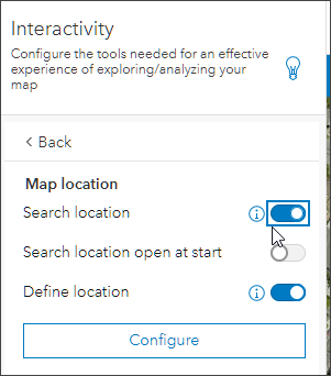

In the Interactivity panel, set Search location on:
This will add a location search to the advance/play tools in the upper right.
If you search for a location using that tool, all other maps in Portfolio will go to that location.
Note that you can also define the location for all maps to zoom to by toggling on Define location, then clicking Configure:

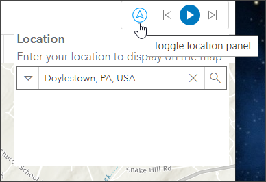

In that example I have defined the location for all tabs to open to Riverside, CA. Use the toggle location panel tool in the upper right to enter a new location:
This overrides the default location settings and all tabs will open to that new location.

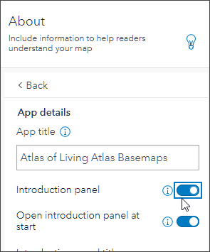

If that seems less than obvious for your app users, you can use the app's Intro panel to provide instructions on how to change the location, and can also set the Introduction panel to open automatically when the app is opened.
BernSzukalski
Esri Frequent Contributor
I forgot to add that you can have that search location tool open when the app is opened, which makes it a lot more obvious.
