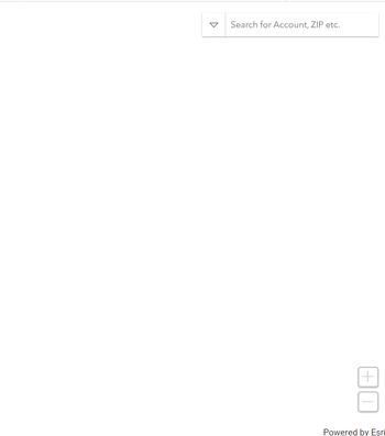

In our application, we are utilizing approximately 8 feature layers through FeatureLayer.
We dynamically generate renderers based on definition expressions on these feature layers. However, we are encountering a serious WebGL error: "Too many active WebGL contexts. Oldest context will be lost." This error occurs when we rapidly zoom in/out and load the map based on the selected dropdown list (definition expressions). we dynamically apply definition expressions on feature layers.
As a result of this error, the map displays as blank, and all added layers are removed. It's worth noting that in the blank map, the search and zoom in/out controls are still visible, but the layers are not showing.
