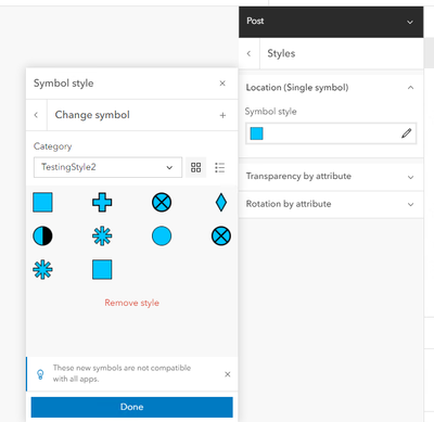

I shared a web style with 10 point symbols in it, then used one of them to update a layer in a web map using one of the new styles.

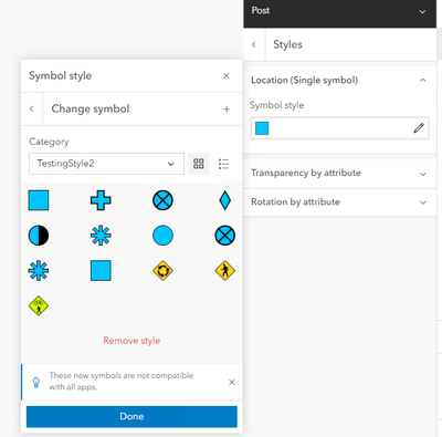

Then, in Pro, I copy/pasted (added) a few new symbols in the style and re-shared as web style using same name.
It warned me that it will be overwritten, I said OK.
Then, in the same web map, I set the symbology again:
and the new symbols added to the style are there, but, did not 'break' the symbology I had already used.
So, yes, it appears as if you can easily overwrite an existing web style.
