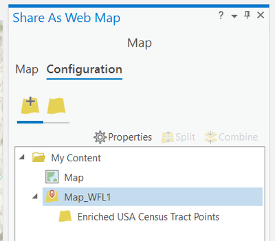

When you publish from Pro you can see if your map content in the sharing panel can you see if you can toggle the shapefile layers to be published as hosted feature layers?  Still looking into the saving issue but I think its something to do with the series of feature collections(shapefile layers) in the web map.
Alexa
Can you give me a little more guidance in how to do that? I don't see anything in the sharing pane.
RussRoberts
Esri Notable Contributor
On the sharing pane - look at the Configuration and you can look at the layer properties for those shapefiles to see if they are being published as web layers.
Alexa
It indicates that only some of them are being published as web layers. Also--and I'm not sure if this is helpful--when I right click on some of the layers in the Contents pane and go to Sharing, the ability to share them as a web layer is greyed out. Again, I'm not sure why as everything is in the same geodatabase.
RussRoberts
Can you copy those shapefiles to a gdb and then try to publish that way? Might solve the issue with them not being all hosted.
