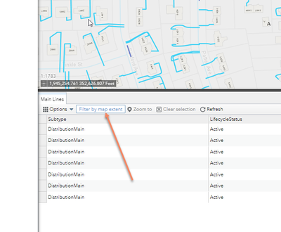

The Attribute table widget in the Old Web Apps has a Filter by map extent option:
Experience builder will also let you filter most the widgets by map extent, including the table widget.
