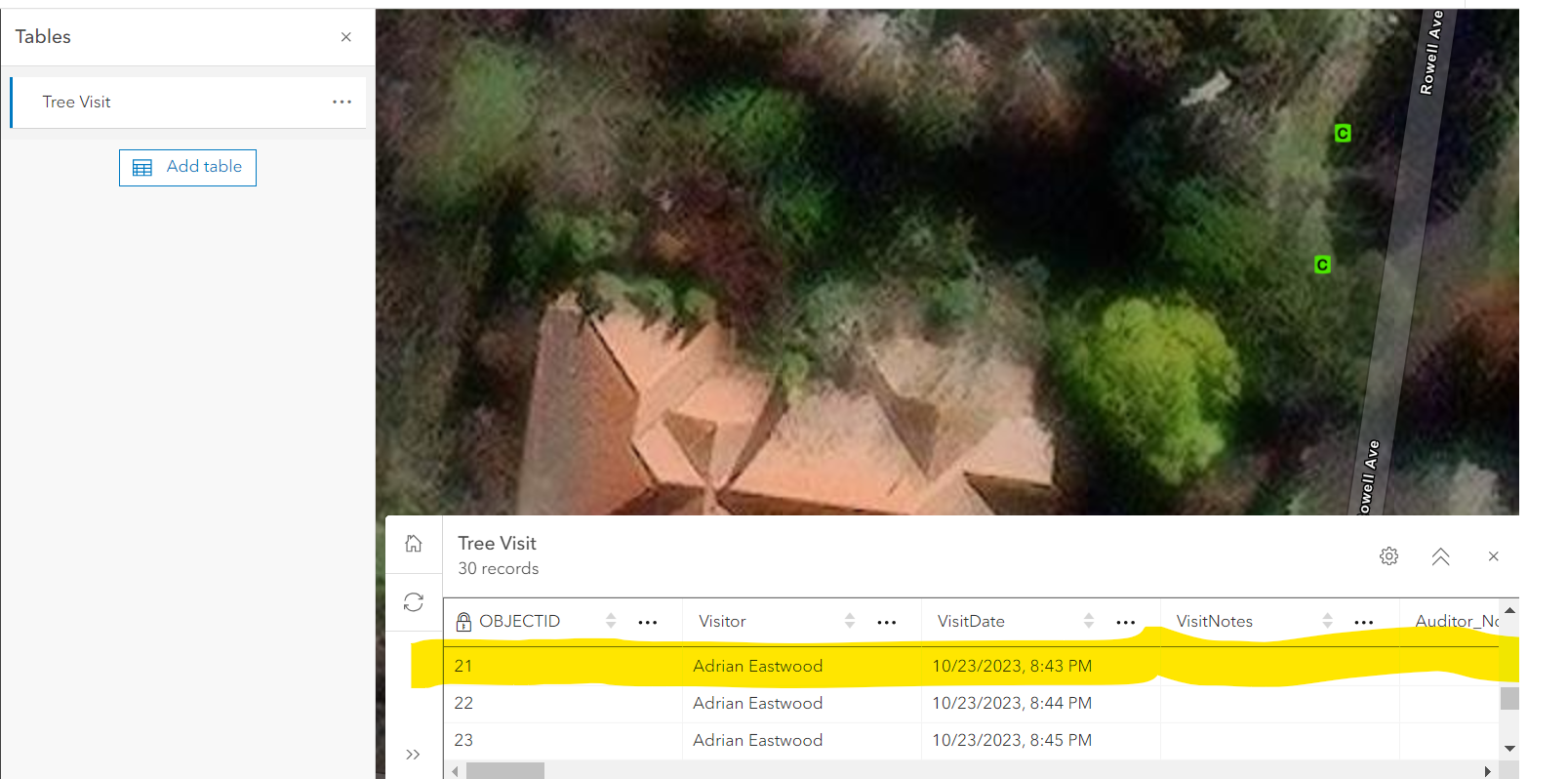

When I open the table for a table layer I can't tell which parent feature belongs to each record
How can I select this record highlighted above? How can I see it's parent record or even the attached photos?

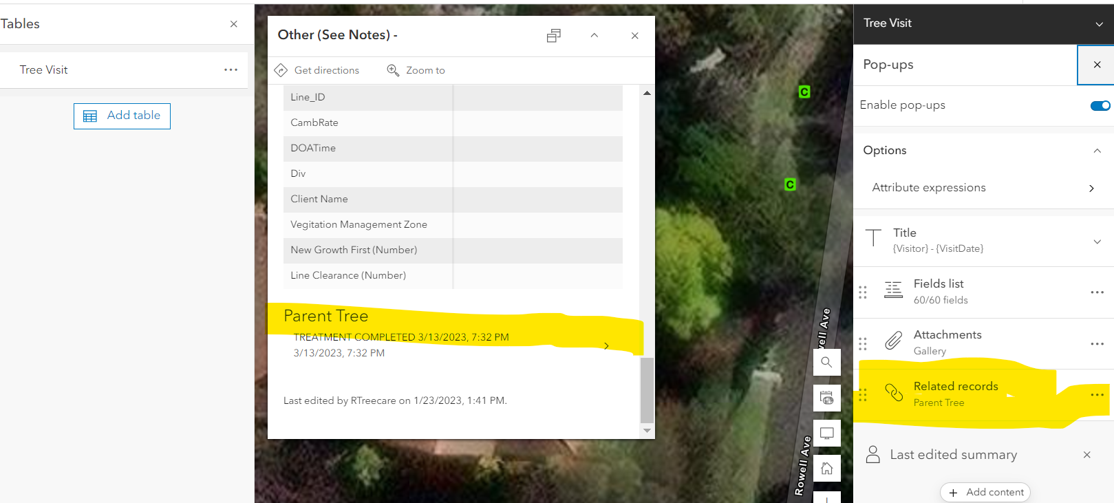

I have configured the popup for this table layer to show the related parent feature. However, I can't figure out how to show the popup for table records within map viewer. Can you see the popup for table records?
Above it the Example popup seen while creating the popup. This shows that a popup would allow for viewing the parent record.

@DavinShokes1 - You are right the pop-ups are not initiated when you select the table record. In fact, you cannot even "select" the table record.

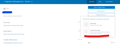

2) You could also simply create a joined view to see the Parent attributes
Follow the steps in the Wizard to get a joined view.
You can join the layer to the table the result of which will be a table with attributes from parent layer.
You could also do it the other way to join the table to the Layer. This will retain the spatial component and allow you to zoom/pan to the map.
