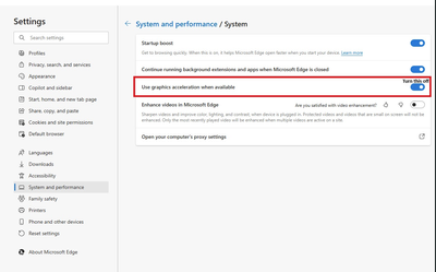

Brian_McLeer
MVP Regular Contributor
We had a user call with as similar issue for one particular machine. The resolution for him was to disable hardware acceleration within the particular browser.
