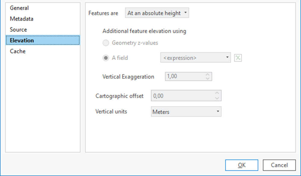

A workaround could be to assign a cartographic offset in ArcGIS Pro and then create the scene layer package but the possibility to assign a cartographic offset for a Revit model is greyed out:

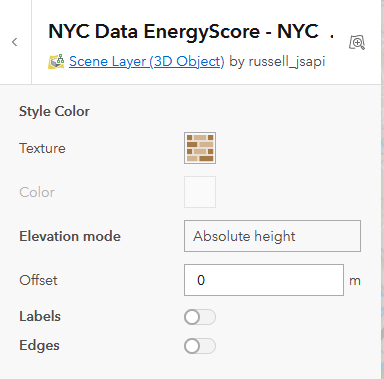

This is not supported on BIM layers yet. You will find this property under other scene layers like 3D Object that support being styled in Scene Viewer.

Thanks @RussRoberts, you are right. I was confused, i went back in my history projects. I had converted the BIM file to a geodatabase and then published it to AGOL. This will allow to add an offset to a layer.
