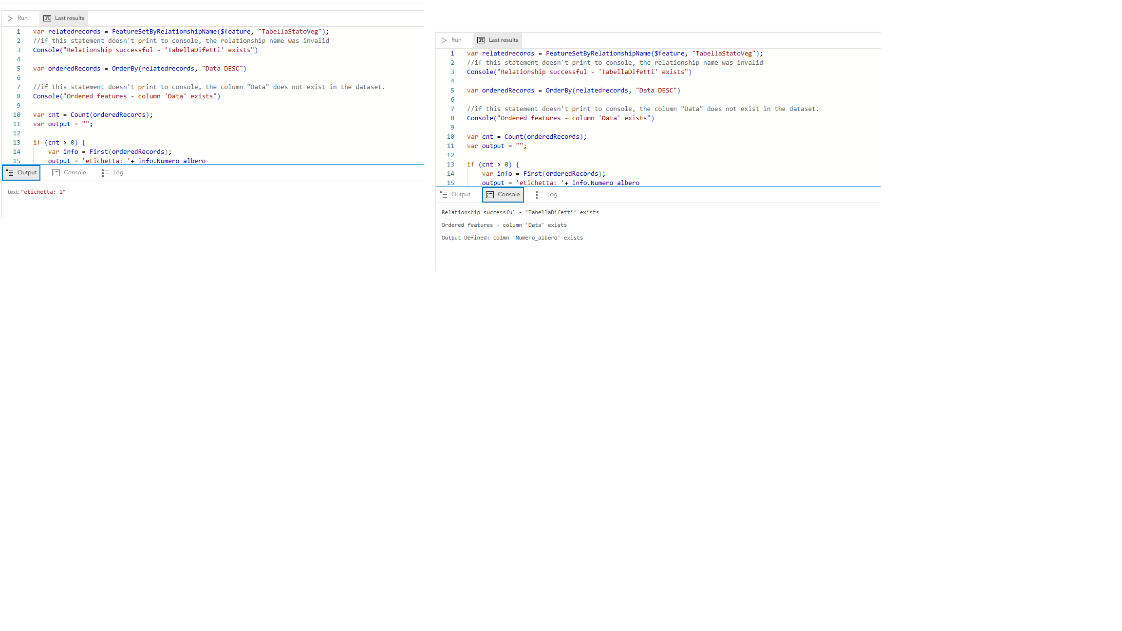

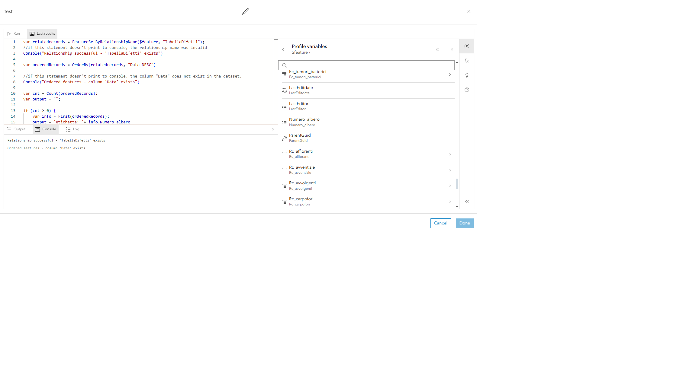

CarlaNardinocchi
Thank you for your help!
I checked with Console statement and this one is the output:
Relationship successful - 'TabellaDifetti' exists
Ordered features - column 'Data' exists,
so it look like that Numero_albero doesn'exist, but It does. See attachment.
Shouldn't an error in the feature name produce a different error in the Output?
Without changing anything, expect the name of the table, I use the same code for other three table (that have the same Numero_albero field) with no error.

CarlaNardinocchi
No, they are number field, too.
I attached the result where I changed the related Table!
As you see, this time Numero_albero is present!!!
