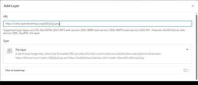

I have not found a way of adding a Tile service to Content.  When I add a URL such as https://a.tile.openstreetmap.org/{z}/{x}/{y}.png I do not get an option for Tile Layers.  However, if I add the same service to either Map Viewer or Map Viewer Classic, I do get the option:
That was for MV.  MVC is a bit different:
Should work with output type .pbf too.
