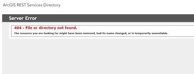

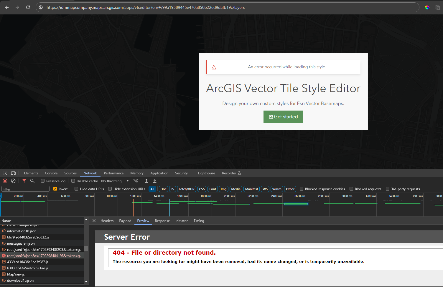

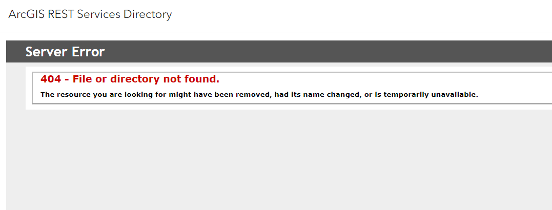

Hello, I upload shp files to my Arcgis Online account. I create a Feature layer. The Feature layer works without any problems. Then I create a Vector Tile layer over my Feature layer. It is published successfully. But when I try to view the layer, I get the error "An error occurred loading this layer". When I press "View Style", I get the error "404 - File or directory not found."
Map Viewer Error:
View Style Error:
Edit in Vector Tile Style Editor:
