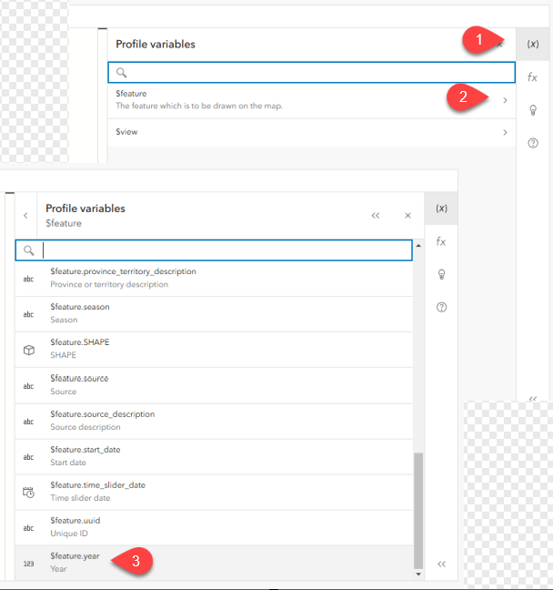

Note that I am using $feature.year, but that might be slightly different for you based on your Year field name. The easiest way to determine what that value should be, is to use the variable picker to add it to your expression for you.
In the style panel, you can then assign your desired symbology to those buckets.
