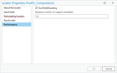

1. You can open the properties of the local composite locator in ArcGIS Pro 3.1.2 and select the Performance tab. In formation about the participating classic locators will not be accessible.
2. If multithreading is enabled, uncheck it and publish the composite as a service and try geocoding with it in AGOL again. Do you get the same behavior?

Thanks. I wasn't looking in Pro but was in ArcMap 10.7.1 since that is were we published it from. Multithreading is checked. I can't do anything at the moment. I need to wait until after business hours to try.
