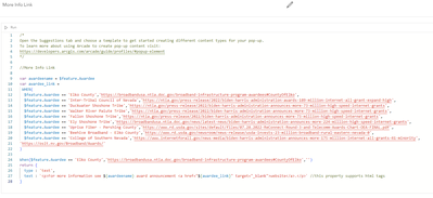

One thing I'm noticing is that you're working in the Text section for adding content to Pop-Ups. You might be better off using the Arcade section (circled in green below) for setting the logic and formatting the html.
If you have a lot of links/states then a dictionary is probably the easiest way to go about it. If you want to hardcode the state weblinks one by one then this example might work for you.
//More Info Link
var awardeename = $feature.Awardee
var awardee_link =
 WHEN(
  $feature.Awardee == 'Elko County','https://broadbandusa.ntia.doc.gov/broadband-infrastructure-program-awardees#CountyOfElko',
  $feature.Awardee == 'Inter-Tribal Council of Nevada','https://ntia.gov/press-release/2022/biden-harris-administration-awards-189-million-internet-all-grant-expand-high',
  $feature.Awardee == 'Duckwater Shoshone Tribe','https://ntia.gov/press-release/2022/biden-harris-administration-announces-more-73-million-high-speed-internet-grants',
  $feature.Awardee == 'Walker River Paiute Tribe','https://ntia.gov/press-release/2022/biden-harris-administration-announces-more-73-million-high-speed-internet-grants',
  $feature.Awardee == 'Fallon Shoshone Tribe','https://ntia.gov/press-release/2022/biden-harris-administration-announces-more-73-million-high-speed-internet-grants',
  $feature.Awardee == 'Ely Shoshone Tribe','https://broadbandusa.ntia.doc.gov/news/latest-news/biden-harris-administration-announces-more-224-million-high-speed-internet-grants',
  $feature.Awardee == 'Uprise Fiber - Pershing County','https://www.rd.usda.gov/sites/default/files/07.28.2022-ReConnect-Round-3-and-Telecomm-Awards-Chart-OEA-FINAL.pdf',
  $feature.Awardee == 'Beehive Broadband - Elko County','https://www.rd.usda.gov/newsroom/news-release/usda-invests-23-million-broadband-rural-eastern-nevada-0',
  $feature.Awardee == 'College of Southern Nevada','https://www.internetforall.gov/news-media/biden-harris-administration-announces-more-175-million-internet-all-grants-61-minority',
'https://osit.nv.gov/Broadband/Awards/'
When($feature.Awardee == 'Elko County','https://broadbandusa.ntia.doc.gov/broadband-infrastructure-program-awardees#CountyOfElko','')
return {
	type : 'text',
	text : `<p>For more information see ${awardeename} award announcement <a href="${awardee_link}" target="_blank">website</a>.</p>` //this property supports html tags
Here is the link to the map for context: https://experience.arcgis.com/experience/dcc4af391f864b2c980de3473bf3e069?data_id=dataSource_1-18749...
