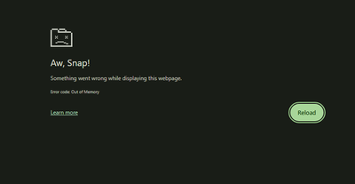

A few minutes after pressing test, I am met with this lovely screen : (

Yikes! How many distinct values are there, anyway?

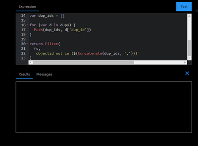

so i tried that expression and i once again encountered the issue where it does not give any results and does not let me press "done" to exit the expression. if including the nulls, then there are plenty of cases with more than 1 duplicate (although, id rather not include the nulls). there probably will be cases in the future where there is more than 1 duplicate and id like for it to display those as well.
