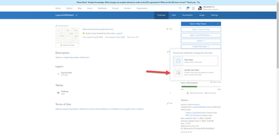

As @EricWagner4  mentioned, the option to create a Hosted Feature Layer View Join is not available in the Join Features tool in Map Viewer.
There's a new way to create a hosted feature layer view from a join, located on the item details page of your target layer. You can check out the documentation here and this great blog post about the new method.
Hope that helps!
Amanda
