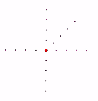

You're trying to use a list of layers as input, but the tool expects a layer.
So you will have to create your output fc and iterate through your SampleLines and append the result to the oputput fc.
Or you can do it with an InsertCursor. And at that point, you can take the next logical step and skip the tools altogether and just use the geometry methods.
input_point_fcs = ["TestPoints"]
bearings = [0, 90, 180, 270, 45]
distances = [50, 100, 150, 200]
output_folder = "memory"
output_name = "result"
output_fc = arcpy.management.CreateFeatureclass(output_folder, output_name, "POINT")
arcpy.management.AddField(output_fc, "Source", "TEXT")
arcpy.management.AddField(output_fc, "Bearing", "DOUBLE")
arcpy.management.AddField(output_fc, "Distance", "DOUBLE")
with arcpy.da.InsertCursor(output_fc, ["SHAPE@", "Source", "Bearing", "Distance"]) as i_cursor:
    for point_fc in input_point_fcs:
        with arcpy.da.SearchCursor(point_fc, ["SHAPE@"]) as s_cursor:
            for point, in s_cursor:
                for bearing in bearings:
                    for distance in distances:
                        new_point = point.pointFromAngleAndDistance(bearing, distance)
                        i_cursor.insertRow([new_point, point_fc, bearing, distance])
