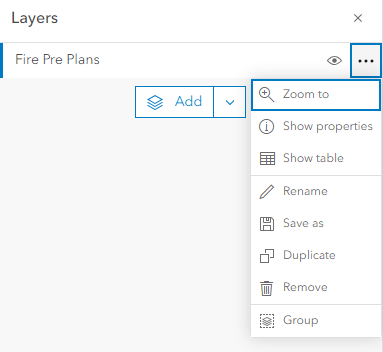

I have a hosted feature layer that I shared with the organization, as well as a group.  Another user who has creator/publisher access, and is also part of the shared group; went in to edit some of the data.  When trying to save however; "Save As" is the only option available and he can't simply save the changes.
Has anyone else run into something like this before?  I can't for the life of me figure out what's wrong as this has never happened before.

  2. Save the Layer: Saving the layer is a separate thing that pertains to preserving properties such as the style, pop-up, forms, and labels. The 'Save as' button in the screenshot you shared is for saving the layer with those properties configured.

no.  It's just the feature layer being edited and saved.  This is what I have...

Thanks for the additional context. Yes, that is expected. The ability to save a feature layer allows a user to save their configurations on the layer- the styling, form, pop-up, labels, etc.
Since they do not own the layer, they cannot save those changes to the layer directly but they can save a copy with their configuration for future use in other maps.
