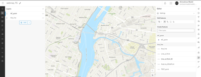

It looks like these are set up correctly based on the screenshot you shared. What do you see when you try to use the template in ArcGIS Online to create a feature?
anonymous55
Editing is not loading when I try to use it in WebMap. When I click on the create features, nothing happens.
Also, when I go to Shared Templates, I can't save because the OK button is grayed out.
