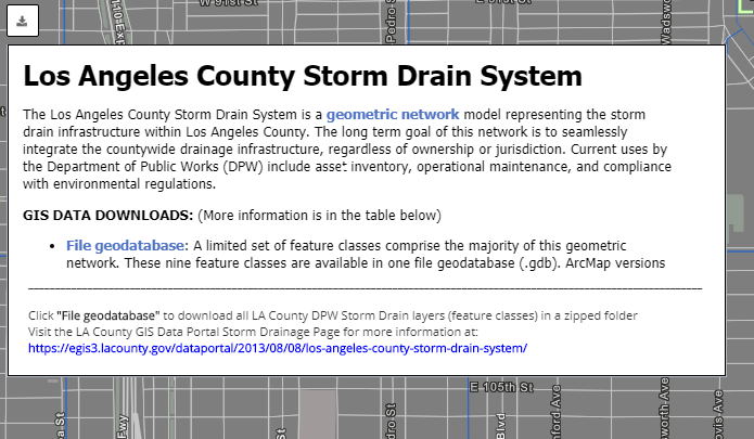

BrandonPrice
Hi Robert,
I was able to get this to show:
All with html:
<div id="stormwaterdownload">
<div style="position:absolute; left:10px; top:242px; z-Index:999;">
<div data-dojo-type="dijit/TitlePane"
data-dojo-props='open:false'>
<div data-dojo-type="dijit/layout/ContentPane" style="width:640px; height:284px; overflow:auto; font-size: 11px;">
<iframe width="870" height="500" frameBorder="0" scrolling="no" src="https://egis3.lacounty.gov/dataportal/2013/08/08/los-angeles-county-storm-drain-system)" style="margin-left: -270px; margin-top: -310px;"></iframe>
<p>______________________________________________________________________________________________________________________________<p>                                                                                                                                                                                                      <p>Click <b>"File geodatabase"</b> to download all LA County DPW Storm Drain layers (feature classes) in a zipped folder</p>
<p>Visit the LA County GIS Data Portal Storm Drainage Page for more information at:</p> <p></p><a target="_blank" href="https://egis3.lacounty.gov/dataportal/2013/08/08/los-angeles-county-storm-drain-system/" style="color: blue">https://egis3.lacounty.gov/dataportal/2013/08/08/los-angeles-county-storm-drain-system/</a></p>

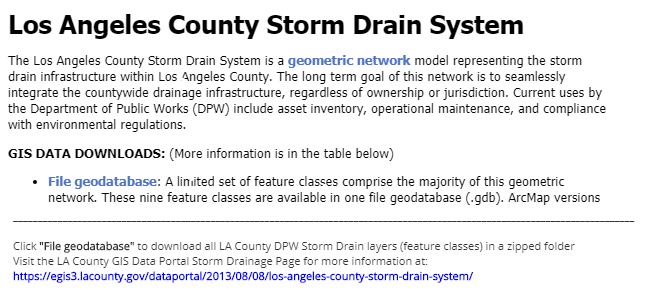

BrandonPrice
(Better image)
