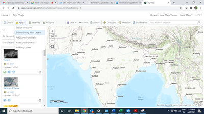

Open ArcGIS Online Map and Go to Add button and select Browse Living Atlas layer
Type USA NAIP

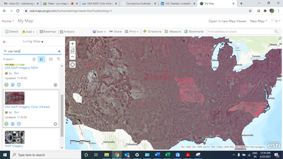

Select USA NAIP Imager: Color Infrared
If still you are not able to access the USA NAIP Imagery color infrared, please update the google chrome, clear all cookies and try it.
Or else using the link https://naip.arcgis.com/arcgis/rest/services/NAIP/ImageServer to access the data.
