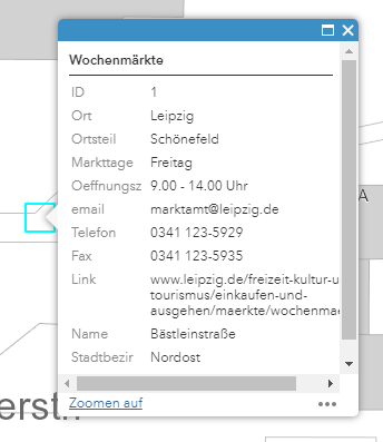

I want to generate an URL parameter that querys a layer (that is not switched on in my WebMap) in a Web Mapping Application and turn on the queried layer.
It works so far that the feature is correctly queried, but because the layer is not swiched on, the symbol for the feature is not shown. Looks like this:
So I want to turn on the layer visibility so that the symbol is shown.
