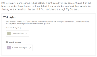

to use the Web Style you publish in Map Viewer(Not Map Viewer Classic) you will need to share it to a group that the org has been configured to use. Clipped out the text from the blog below:
https://www.esri.com/arcgis-blog/products/arcgis-online/mapping/use-published-2d-symbols-in-arcgis-o...
We have plans to support browsing to web styles without the need to use a configured group but we wont get to that feature until mid 2023.
