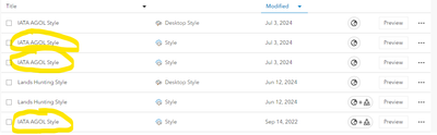

When I share a new web style with the same parameters and name as the previous one, I don't get prompted to overwrite it.  It just creates a new web style.  Using ArcGIS Pro 3.3.1.  Thoughts?
TiffanyStram
I figured out the issue.  The folder that contained the web styles was named "Map symbols, graphics, logos".  It appears that ArcGIS Pro is unable to find an existing item if a "," is present in the folder name in ArcGIS Online.  Once I renamed the folder without commas, I was prompted if I wanted to overwrite the existing web style.
