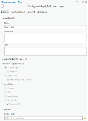

Thanks for bearing with me.  So, I drilled down into the 'Share As Web Map' configuration to share feature, but the feature checkbox option is grayed out (along with others).  The test map contains a single layer to be shared and is an Enterprise Geodatabase Polygon Feature Class and will need to reference registered data.  There are no errors when running 'Analyze'.
Any thoughts on why the feature checkbox would be grayed out?  I assume this is what you suggested I should do.  Let me know.

TylerT
From the docs, looks like I might need to share an editable map vice exploratory.
I'll give that a go and see I can manage your recommended workflow for creating a web map that is readily updatable (symbols, labels, etc...) from ArcGIS Pro.  Thank you.

jcarlson
MVP Alum
What I would suggest:
  1. Publish all your layers to your portal however they need to be published
  2. Add the published services to your map
  3. Do "share as web map"
If you try to use "share as web map" with local layers, the process will need to publish those as well, and that can lead to trouble. When you share as a web map with already-published layers, things should go a little more like you expect.
