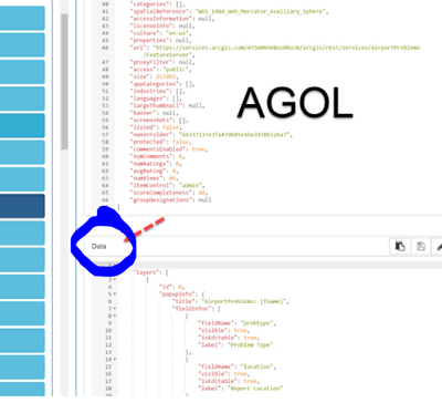

Hi @jcarlson thank you for your answer.
 A couple of questions:
I have already overwritten the hosted feature layer from PRO.
Alter the JSON from AGOL Assistant?
is it enough to overwrite the Data tab in full?
Do I have to alter also the Description tab anywhere?
