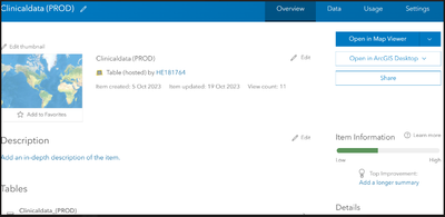

We are having a 'strange' issue recently.
We have a table published from an uploaded *.csv file to ArcGIS Online as a feature layer.
The feature layer is shared via a Group which allow members updating the contents.
Our issue is ONLY admin/owner of the feature layer can see the 'Update Data' button.
Other uses in the GROUP can't see the 'Update Data' button in the overview tab.
PS: other users can perform editing in the table of 'Data' tab.
Wondering is this expected? or something we are missing to allow the group users to be able to 'Update Data'?

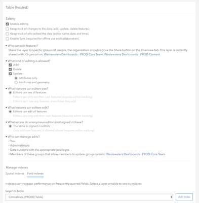

3. Feature Layer Settings.
Feature Layer SettingFeature Layer Setting
4. Other users (Publisher role) can't see the 'Update Data' option.
Other Member with Publisher Role can't update dataOther Member with Publisher Role can't update data

Hi  Leo_Liu_WA,
Yes, this is expected. Only the item owner or the organization administrator will be able to view and use the Update Data dialog on the item details page.
