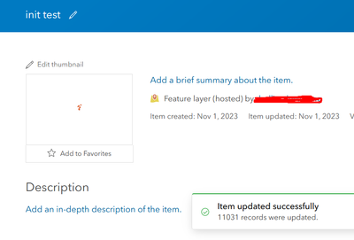

Thank you for replying! It seems that the upsert process has finished by now. I don't know if it have gotten slower after the update?
I've pasted the two geojsons in my post but you can also use these larger geojsons in the link here
Note that the data is from Open Street Maps and can be used freely
The 'init.geojson' is the initial file to create the layer
The 'upsert.geojson' is the file i use to update my layer with
It took me around 40 mins this morning to perform this operation. Two weeks ago it was a couple of mins. It would be very helpful if you also take a look 😄
