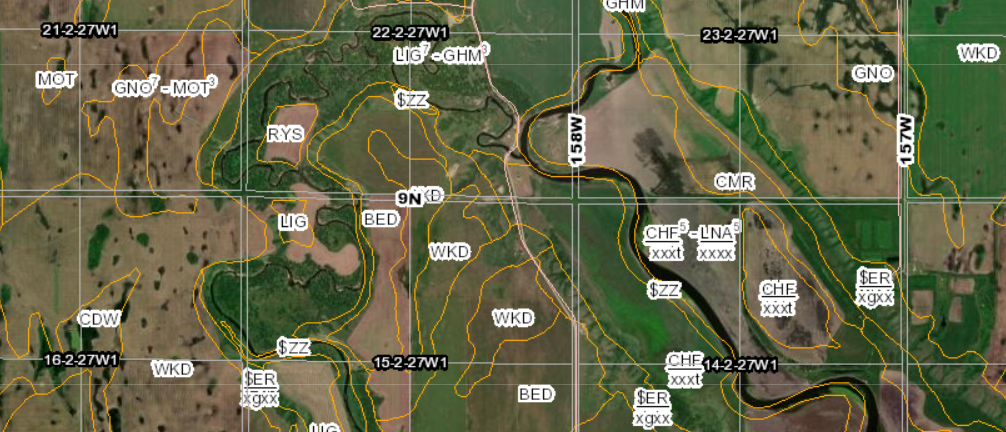

A screen shot of the app below shows the labels displayed as expected in the existing WAB app.

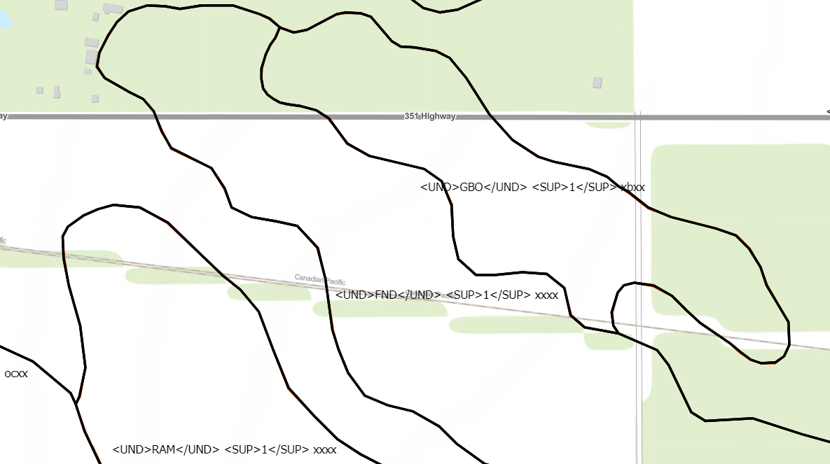

But attempts to recreate the labels in an ArcGIS Online map have not been successful. Here’s what we’ve tried:
  • Configuring the labels with the above VB expression in ArcGIS Pro and sharing the map via ArcGIS Pro causes the labels to disappear entirely in ArcGIS Online’s map viewer and map viewer classic.
  • Configuring the labels with the following Arcade expression in ArcGIS Pro and sharing the map via ArcGIS Pro looses the underline and superscript formatting in map viewer and map viewer classic. "<UND>" + $feature["SOIL_CODE1"] + "</UND>" + " " + "<SUP>" + Left($feature["EXTENT1"],1)  + "</SUP>" + TextFormatting.NewLine + $feature["CLASS1"]

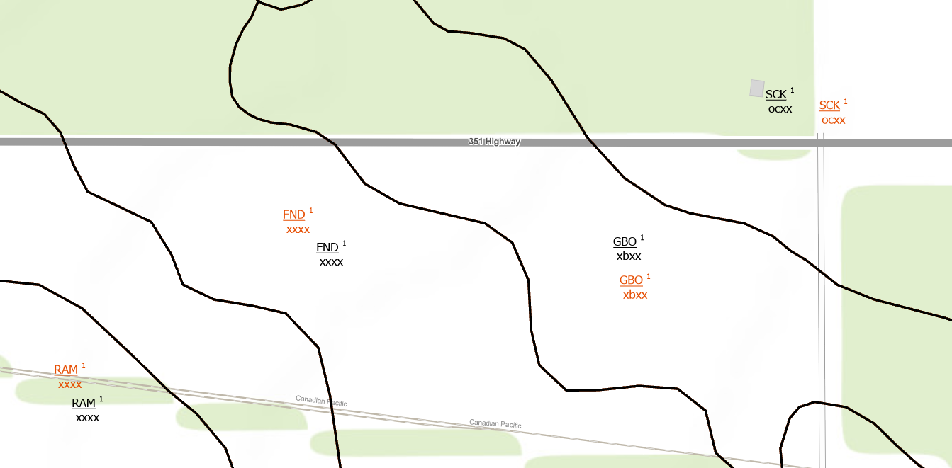

Here’s the VB (red) and Arcade (black) expressions working as expected in ArcGIS Pro:
But not in ArcGIS Online:
Can someone help us understand what we’re missing? Either a) how to replicate the existing labels seen in our WAB app in our new ExB app or b) how/why this was possible to do with our VB/ArcMap/ArcGIS Server/WAB work in 2016, but not today with the current technology Arcade/ArcGIS Pro/ArcGIS Online/ExB?

I don't believe this possible in AGOL. Arcade has HTML formatting tags in Pop-up profile but not for Labels.
I haven't tried this but you could possibly change your labels to annotations and have them show up with the right formatting. Although this will open up another set of problems as they will not be dynamic as you zoom and pan around.

Thanks @gis_KIWI4. I understand now that ArcGIS Server's Map Services offers more advanced labelling options than ArcGIS Online. It's not possible to do this in AGOL with arcade.
