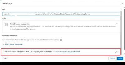

Attempting to add  ArcGIS Server 10.9.1 secured feature service to AGOL as an item, using URL.
I can add the service to a map, enter credentials, and they are accepted, save the map, no issues.  But when I add the item and say 'save credentials' it fails, says invalid user name or password.  The error details are attached.
We have investigated ArcServer config, webadaptor and IIS settings, reverse proxy settings - to the best of our knowledge this should work - and we use this fairly simple workflow on our current production environment (which is 10.7.1) - So I am left to wonder if this is a bug for 10.9.1, or something with our reverse proxy passing credentials?  But you CAN pass credentials, AGOL just can't save them.

I do see that option, and when I activate it, enter credentials, all seems well.  It's when I get to the final step to save the new item in AGOL when I get the helpful message 'An error has occurred' -
So AGOL can see the service and even pass credentials, but will not save them for whatever reason.
We have the same set up our current Prod  system, with a 10.7.1 ArcServer/Web Adaptor set up using the same reverse proxy entry.  The only difference we can see is that the one I am testing is using Enterprise 10.9.1
