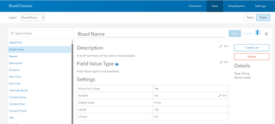

I'm trying to save some edits in the Fields section but it seems to be stuck on save and then eventually fails to save altogether. Does anyone know how to resolve this issue?

Yeah it would have been nice if the error message was more specific. Anyways may be try entering the labels without any spaces and see if that helps? But wait the datatype is already string. Do you have the layer's attribute table open else where? Maybe exit out of any application(s) that maybe using the layers.

I've closed all applications using the layer, but it's still stuck on Save. I've also tried saving in a different browser but that doesn't work either.

Does it only happen when updating a particular column or any column?

For all columns. I can create new columns without any issues. It's updating existing columns that is being stubborn right now.

Maybe check the hosted feature layer settings and see if editing is enabled. If so, then I can guess you can also import the hosted feature layer to Pro and see if it updates in Pro. Otherwise I guess then you can update the feature class in Pro and republish the layer by overwriting it.
