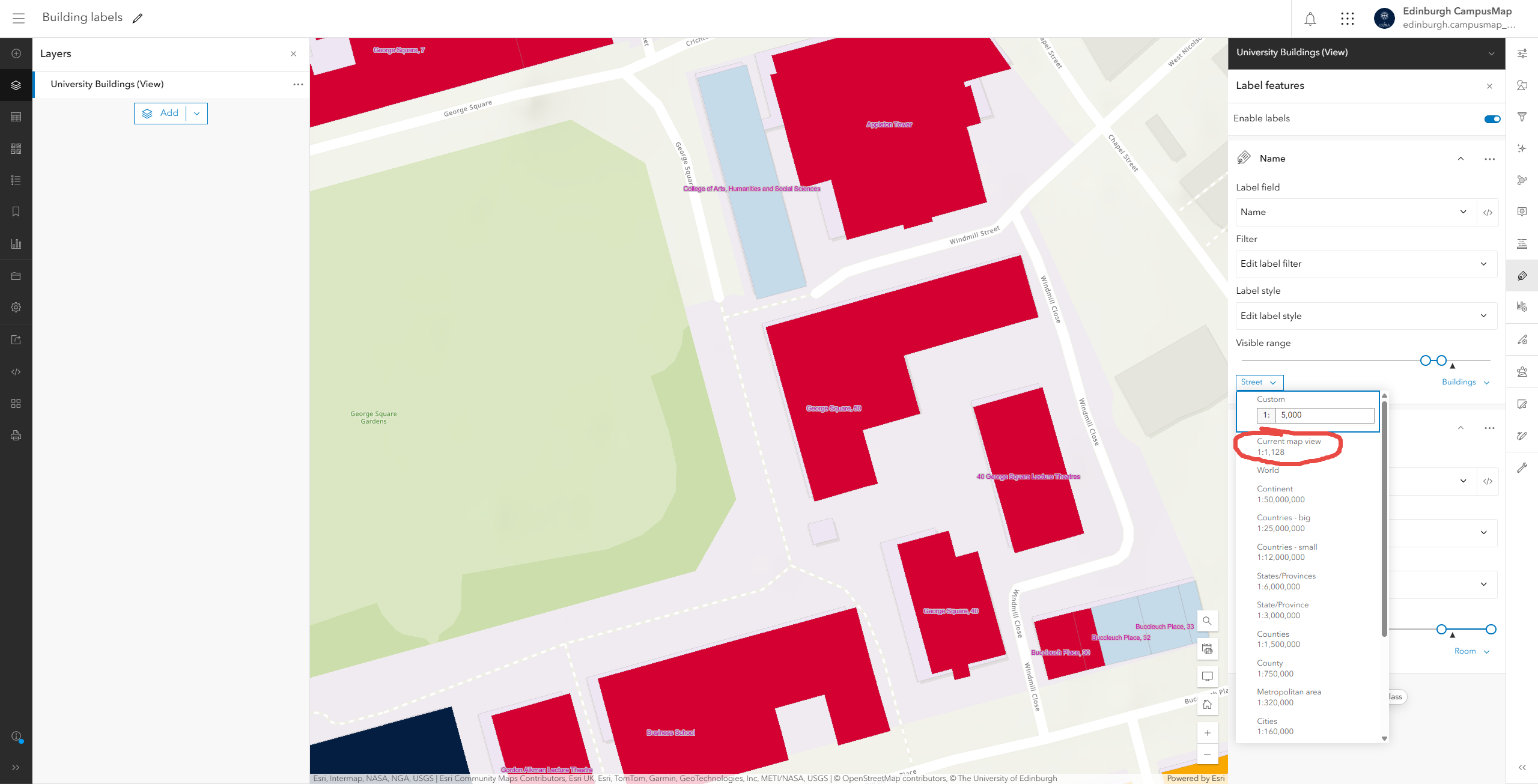

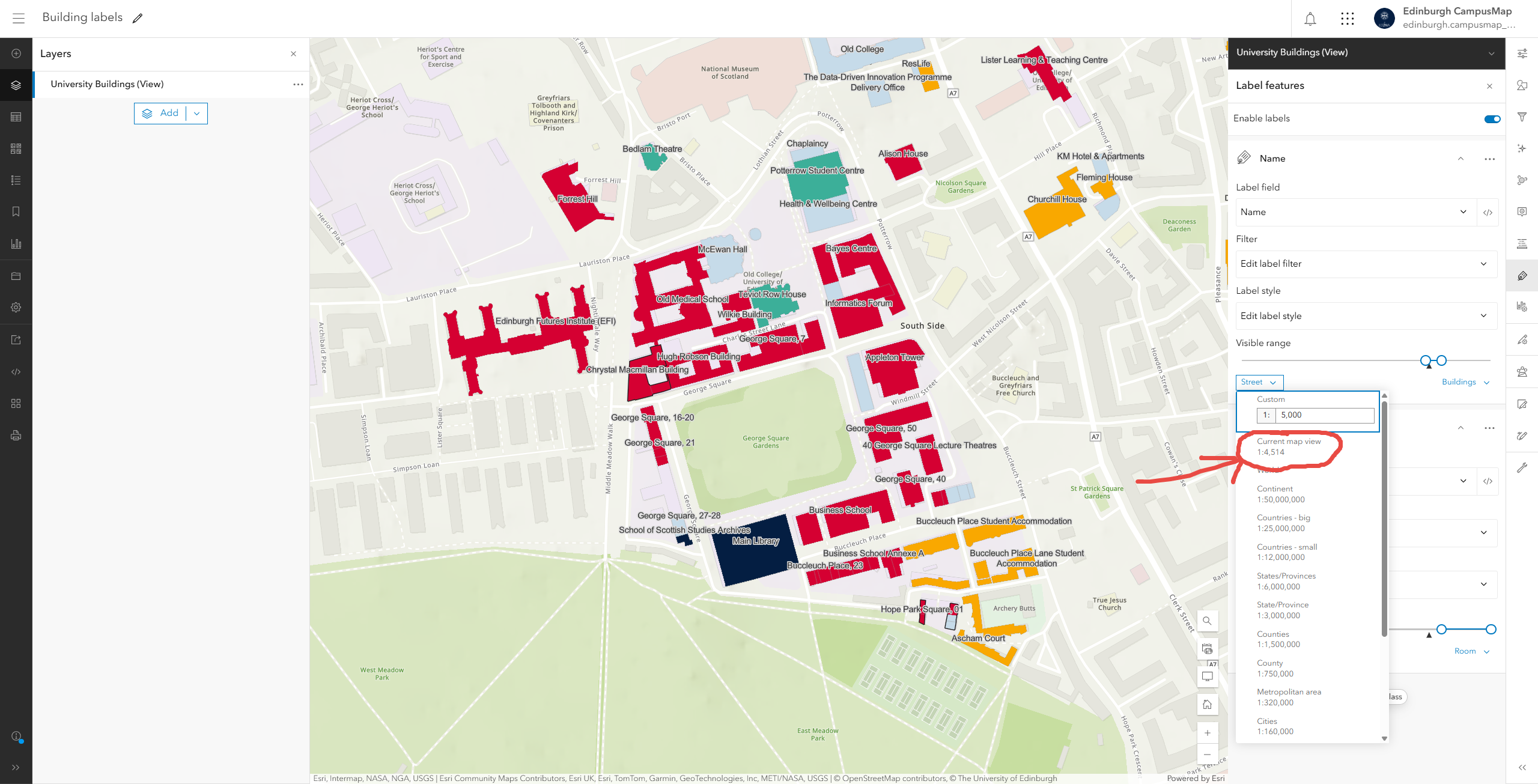

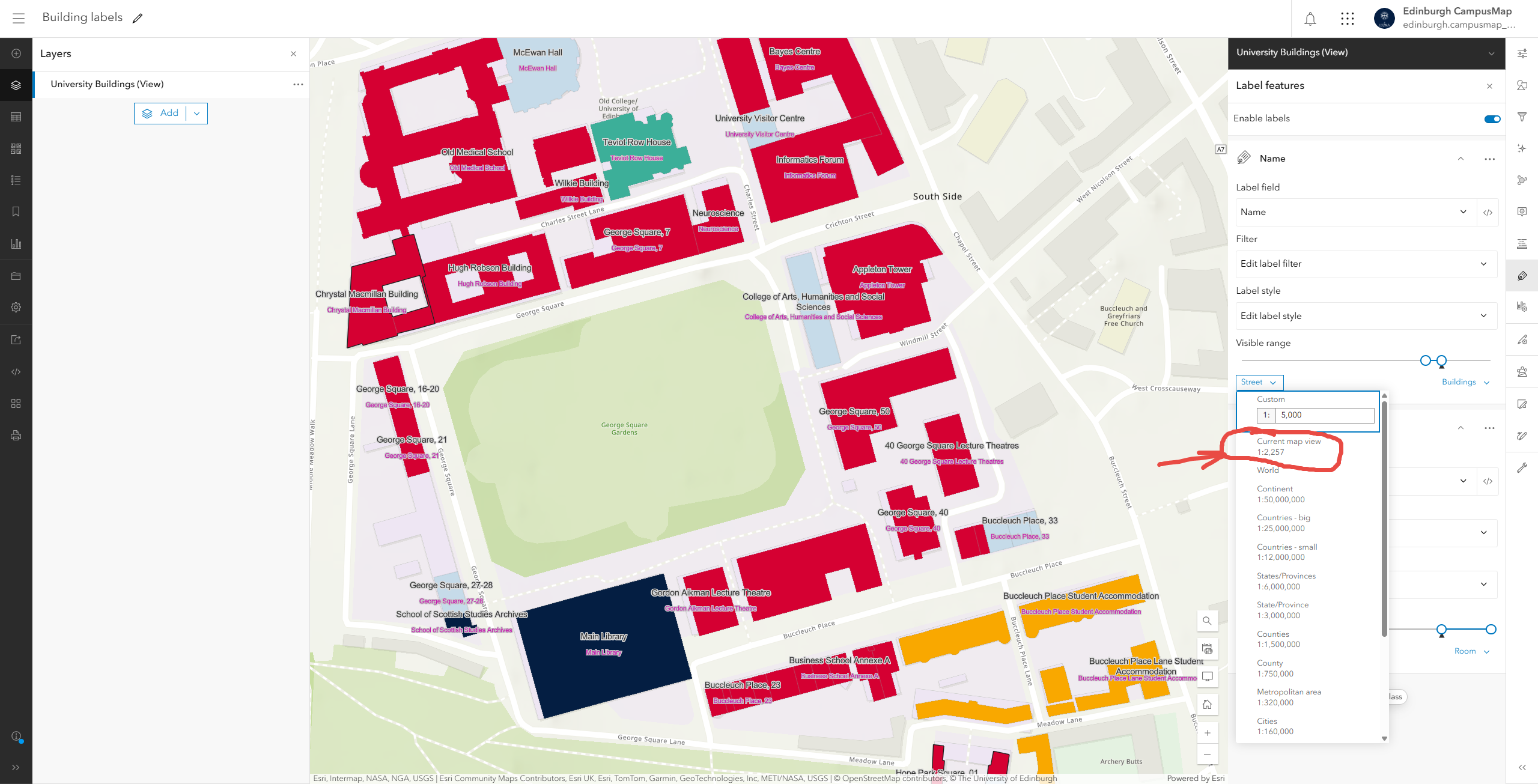

Thank you for sharing that link to the map I hope you don't mind I started to play around with it. I think in the visibility range there will be slight overlap but I took both labels to the full visible extent and then narrowed down
DanielFox1_0-1746112649815.pngDanielFox1_0-1746112649815.pngDanielFox1_1-1746112665335.pngDanielFox1_1-1746112665335.png
I think at your scales 1:2000 and then 1,999 are to close together and the scaling zooming in and out cannot tell the difference, you need to end one of the labels with a certain scale like in my screenshots and start the other with the same.

I have used the slider to just slide the bottom small labels past the current view line this means that both do not display at the same time and will transition across the scales
So buildings at the top is 1:2000 and the small labels is building at 1:1250 with current view at 1:2257
